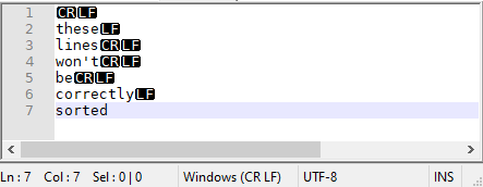

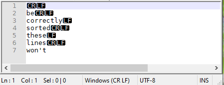

                    • r lR
                      r l
                      It seems that in Notepadd++ 7.7.1 there needs to be at least one empty line after the last line of text, otherwise the sorting function doesn’t do anything.
                      If end of file is in an empty line after the last line of text, sorting works:
                      text
                      text
                      <EOF>
                      If end of file is at the end of the last line of text, sorting doesn’t work:

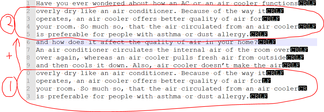

                        Alan Kilborn @r l
                        This is NOT true when I try it. Can you provide anything more to help reproduce?
                        • r lR
                          r l
                          You’re right. And I just realized what my mistake was.
                          I had searched and replaced certain character sequences prior to sorting, to insert linebreaks. In Notepad++ that linebreak must be “\r\n” rather than just “\n”. With correct linebreaks, sorting works fine. With just “\n”, the sorting function sees the whole file as one single line. Likewise, when I add an empty line at the end of the file, it only sorts that empty line to the beginning of the file but doesn’t change the sequency of anything else.
                          So, sorry for the noise… :-)

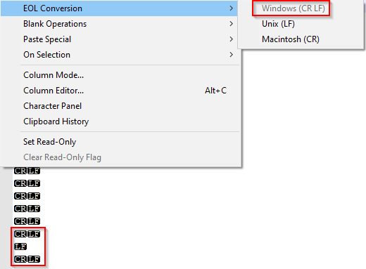

                                    • aarocaesA
                                      aarocaes
                                      • aarocaesA
                                        aarocaes
                                        Maybe it could be helpful for anyone else. I had this issue, and the problem was related with the line break codes.
                                        Even if you are seeing different lines, is possible that only one of the line break codes (\n or \r) is being used. If that’s the case, sorting won’t work as it will take all the text as just one single line. You can check this enabling the “Show all characters” option:
                                        LF is the code for Line Feed (\n). But it’s missing the CR (Carriage Return, \r) code. Unlike Unix systems, standard line-termination in Windows and in the Internet is \r\n.
                                        So if you replace these line-termination codes activating the extended search mode (replacing \n with \r\n), it will work.

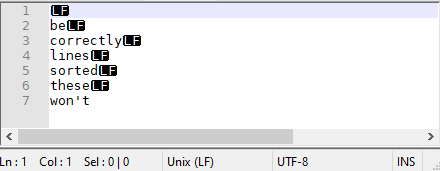

                                          PeterJones @aarocaes
                                          @aarocaes ,
                                          Interesting. It sorts correctly for me.
                                          I thought maybe if you have mixed line endings, where some don’t match the current line-endings mode:
                                          94dd079f-50dd-4ff3-ae3a-a124003337e8-image.png => 9cc139ab-cde8-41c8-89d1-10cb24fb14fa-image.png
                                          Yeah, that’s it: correctly\nsorted and these\nlines were treated as single lines.
                                          So, as long as you don’t have mixed line endings, and your line endings match the defined line endings setting shown in the status bar, it will work. But if there’s a mix or discrepancy, it won’t be treated as a line ending.
                                          gitberryG 1 Reply Last reply Reply Quote 4
