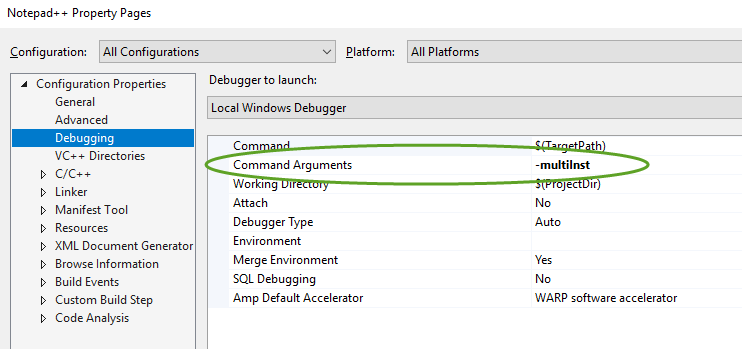

            NB: If debugging NPP from within VS, enable Multi-instance in NPP settings or close other instances of notepad++.exe
              Alan Kilborn @moon6969
              @moon6969 said in Building Notepad++ with Visual Studio 2015/2017:
              Or…what I do is add it to the VS properties like so (shown for VS2019):

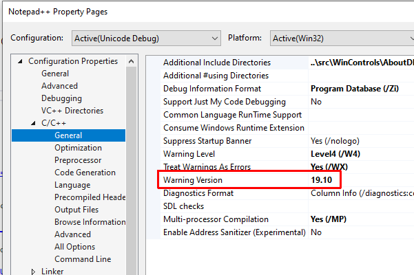

                Build successfull on newly installed Visual Studio 2019 Community Edition. I followed the above v7.8.2 notes.
                On opening notepadPlus.vcxproj, I accepted prompt in VS2019 to upgrade SDK to v10 and Platform Toolset to v142.
                On first build, there is a new C++ warning…
                C4834: discarding return value of function with 'nodiscard' attribute
                VS2019 was treating it as an error, so I added /Wv:19.10 compiler option (to use an earlier C++ versions warnings)…
                  Disclaimer: I’ve no idea what this warning means or the impact of ignoring it… but it seems to work :)
                      Where did you get the idea to use that exact number?
                      (I just turn off “treat warnings as errors” instead when I have built the source code)
                        Ekopalypse @Alan Kilborn
                        the C4834 link directs to this warning setting.
                          Alan Kilborn @Ekopalypse
                          @Ekopalypse
                          Ah, never knew that. Presume one could also use 19.10.25017.0 in this case.
