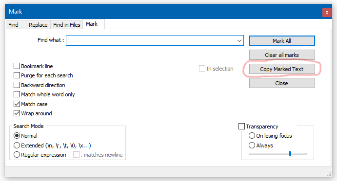

                I think there is an open issue that would make this script’s functionality a native part of Notepad++. I will try to find it…
                  This may be the issue to which I was referring: https://github.com/notepad-plus-plus/notepad-plus-plus/issues/6095
                    At the time of the earlier discussions, there was no way to copy marked text natively in Notepad++, meaning without resorting to scripting. Now (7.9.1-ish) there is:
                    Just press the indicated button after you already have marked some text.
                    Note: I have added similar information in this somewhat-related other THREAD.

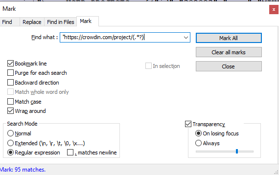

                                @Terry-R Thanks for the quick response, but the Search results window is not what I mean. When I press Alt+Enter (or an alternative key combo) I want every search result to be selected via multi-editing in the editor window, and not in a separate window or sidebar.
                                Right now, with help of the script, I open the Marks search (Ctrl+M), enter my search term and press “Mark all”. Then I run the script to convert all marks to multi-edit selections. I want to reduce these extra steps if possible, i.e. in the best case: Ctrl+F, enter search word, hit Alt+Enter.
                                  It might not be worth it for your case, but the Search dialog in the Columns++ plugin has Select All as an option on the dropdown menu on the Count button.
                                  You can assign a shortcut to Columns++ | Search in Notepad++ shortcut mapper; but at present, there is no straightforward way to open the Count button menu using only the keyboard.
