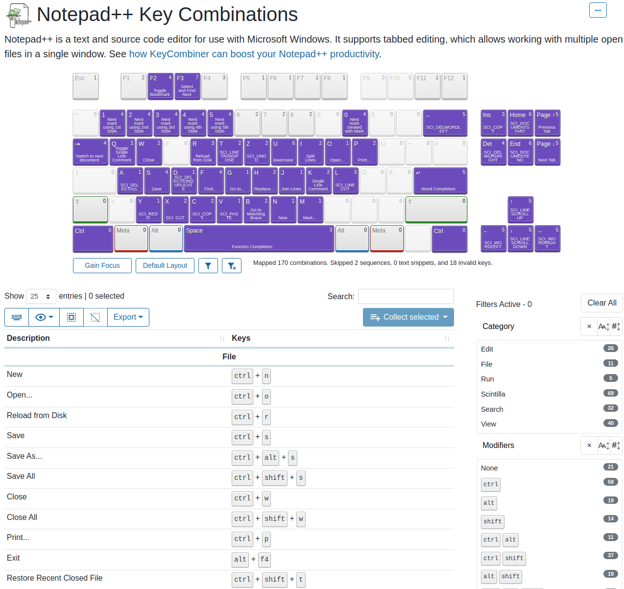

        • cmeriauxC
          cmeriaux
          Try my nightly build of my shortcut branch
          https://ci.appveyor.com/project/cmeriaux/notepad-plus-plus/build/1.0.173/job/xqlj863c7703u23a/artifacts
          I added a function that export default shortcuts in a XML with many comments.
          That may almost suits your needs.

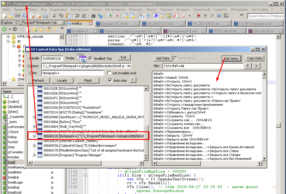

                    Hi, Scott and All,
                    So, continuation of my previous post !
                    Here is below, a third table, with the Windows Virtual Keys values, for the default US keyboard :

                                    • Дмитрий РыжовД
                                      Дмитрий Рыжов
                                      Hi @guy038
                                      I have been looking for a similar table for a long time. Can I see the results of your labors? jang.spb@gmail.com
                                        If I could iterate through it in a python code snippet would work
                                        Just in case some else has the same requirement
                                        import ctypes
                                        import ctypes.wintypes as wintypes
                                        user32 = ctypes.WinDLL('user32', use_last_error=True)
                                        NPP_HANDLE = user32.FindWindowW(u'Notepad++', None)
                                        MIIM_SUBMENU = 4
                                        MIIM_STRING = 64
                                        class MENUITEMINFO(ctypes.Structure):
                                            _fields_ = [ ("cbSize"       , wintypes.UINT),
                                                         ("fMask"        , wintypes.UINT),
                                                         ("fType"        , wintypes.UINT),
                                                         ("fState"       , wintypes.UINT),
                                                         ("wID"          , wintypes.UINT),
                                                         ("hSubMenu"     , wintypes.HMENU),
                                                         ("hbmpChecked"  , wintypes.HBITMAP),
                                                         ("hbmpUnchecked", wintypes.HBITMAP),
                                                         ("dwItemData"   , wintypes.LPVOID),  # ULONG_PTR
                                                         ("dwTypeData"   , wintypes.LPWSTR),
                                                         ("cch"          , wintypes.UINT),
                                                         ("hbmpItem"     , wintypes.HBITMAP),]
                                        npp_menu_handle = user32.GetMenu(NPP_HANDLE)
                                        def get_configured_shortcuts(menu_handle):
                                            menu_items = user32.GetMenuItemCount(menu_handle)
                                            for item in range(menu_items):
                                                uitem = item
                                                fByPosition = True
                                                mii = MENUITEMINFO()
                                                mii.cbSize = ctypes.sizeof(mii)
                                                mii.fMask = MIIM_STRING | MIIM_SUBMENU
                                                lpmii = ctypes.byref(mii)
                                                user32.GetMenuItemInfoW(menu_handle,
                                                                        uitem,
                                                                        fByPosition,
                                                                        lpmii)
                                                if mii.hSubMenu:
                                                    get_configured_shortcuts(mii.hSubMenu)
                                                mii.dwTypeData = ctypes.cast(ctypes.create_unicode_buffer(mii.cch+1), ctypes.c_wchar_p)
                                                mii.cch = mii.cch+1
                                                                     uitem,
                                                                     fByPosition,
                                                                     lpmii)
                                                if '\t' in mii.dwTypeData:
                                                    shortcuts.append(mii.dwTypeData.split('\t'))
                                        shortcuts = []
                                        for i in range(user32.GetMenuItemCount(npp_menu_handle)):
                                            submenu_handle = user32.GetSubMenu(npp_menu_handle, i)
                                            get_configured_shortcuts(submenu_handle)
                                        _max_length = len(max([x[0] for x in shortcuts], key=len))
                                        notepad.new()
                                        editor.setText('\r\n'.join(['{0:<{2}} : {1}'.format(x[0], x[1], _max_length) for x in shortcuts]))
