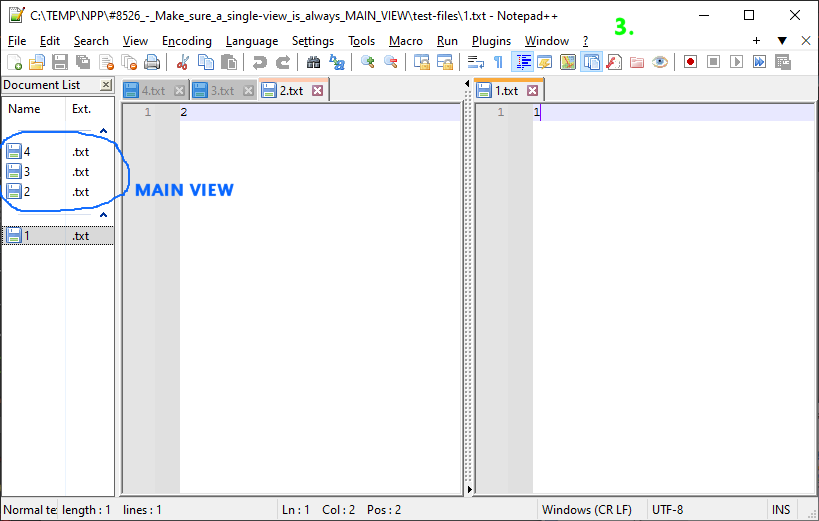

                                • xomxX Offline
                                  xomx @Alan Kilborn
                                  @Alan-Kilborn & all
                                  Due to lack of time I have not fulfilled my promise in that issue yet, sorry.
                                  I looked at this now and it seems to me not as easy as it looks like to Yaron10 there.
                                  I quickly found the right place in the N++ src where to interfere but at the end I found only one way how to do the requested “Make sure a single-view is always MAIN_VIEW” (I just reused the same N++ code activated, while a user manually moves N++ tab to other view, means that I simply moved all that N++ other-view tabs back to the main-view one-by-one in the right order, sigh). So maybe my solution found could become pretty slow with many many N++ tabs, IDK.
                                  Anyway, before any possible follow-up on this issue on GitHub, I would like to know if this patched binary behaves as users here say it should:
                                  http://xomx.wz.cz/NotepadPlusPlus/npp_issue8526_v866devel_x64_Release.zip
                                    Alan Kilborn @xomx
                                    @xomx said in Move to Other View moves the wrong file:
                                    No worries; thanks for your efforts.
                                    Yes, probably that would be true.
                                    What about an alternative idea?: If the second view is open, don’t let the final tab be removed from the primary view (either via a move-to-other-view or a closure) – if this occurs, maybe simply open a blank new # file in the primary view, which would keep that view open. Thus one always has open either primary or primary-and-secondary.
                                    xomxX 1 Reply Last reply Reply Quote 3
