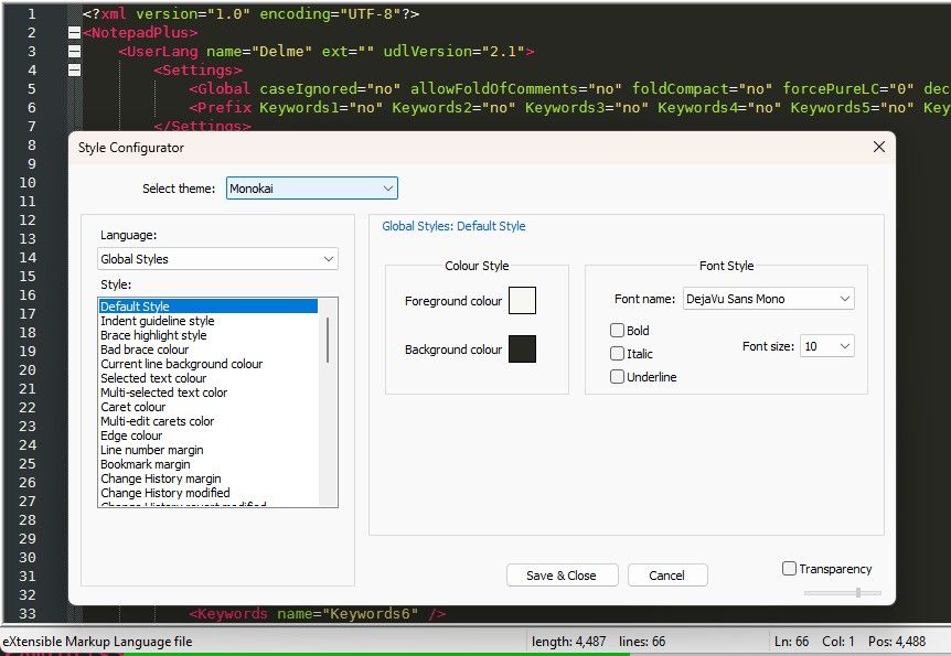

<?xml version="1.0" encoding="UTF-8"?><rss xmlns:dc="http://purl.org/dc/elements/1.1/" xmlns:content="http://purl.org/rss/1.0/modules/content/" xmlns:atom="http://www.w3.org/2005/Atom" version="2.0"><channel><title><![CDATA[Theme, Monokai, change color of highlighted line]]></title><description><![CDATA[<p dir="auto">Good morning.<br />
I have some trouble with themes in notepad++<br />
I use Monokai dark at the moment, so far colors are ok.<br />
What I need is a better highlighed line I am working in, its black on dark that has nothing to do with highlight.<br />
Same problem with most other themes.<br />
If I try to change it via Style congiruator  the line will be solid in the color I choode doesnt matter for fore or background.</p>
<p dir="auto"><img src="/assets/uploads/files/1790238545562-style.png" alt="style.png" class=" img-fluid img-markdown" /></p>
<p dir="auto">Also background is devided in left and right.<br />
<img src="/assets/uploads/files/1790238658952-back.png" alt="back.png" class=" img-fluid img-markdown" /></p>
<p dir="auto">changing background<br />
<img src="/assets/uploads/files/1790238700961-back1.png" alt="back1.png" class=" img-fluid img-markdown" /></p>
<p dir="auto">Absolute strange.</p>

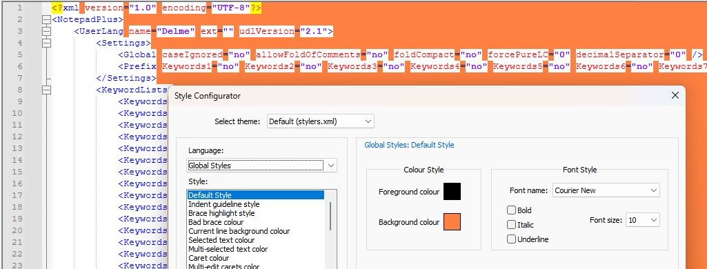

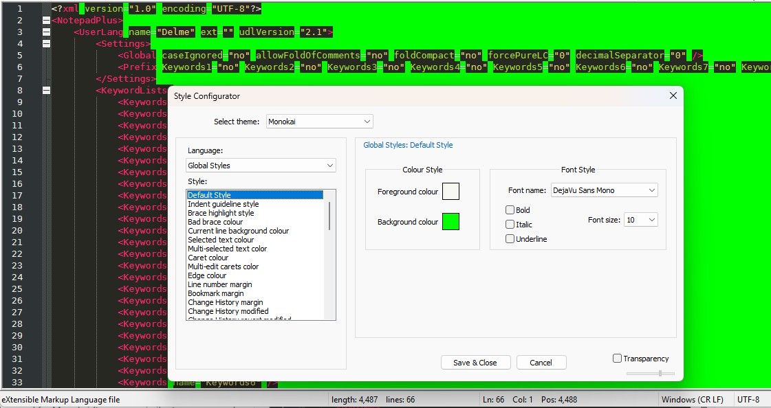

<p dir="auto">However, if I change the Default Style &gt; Background for Monokai (to a green similar to your second screenshot), I can see it:</p>
<p dir="auto"><img src="/assets/uploads/files/1790262414327-b8f97a3a-d5b4-43cd-b0f3-a1c35e66c366-image.jpeg" alt="b8f97a3a-d5b4-43cd-b0f3-a1c35e66c366-image.jpeg" class=" img-fluid img-markdown" /></p>
<p dir="auto">It’s because Monokai (and most themes) hardcodes every background color for every style, rather than using “inherit”.  Here’s an example using the default style:</p>
<p dir="auto"><img src="/assets/uploads/files/1790262562644-9ba07e02-fb1d-4d2f-a580-d6cb2d7d5924-image.jpeg" alt="9ba07e02-fb1d-4d2f-a580-d6cb2d7d5924-image.jpeg" class=" img-fluid img-markdown" /></p>
<p dir="auto">The theme color choices aren’t always perfect, and not everyone is going to agree with color choices made.  As such, you can customize to what you want.</p>

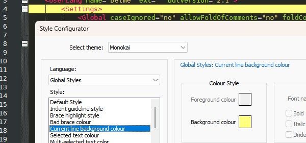

<p dir="auto">Which “highlight” do you mean?  And I am not sure what you aren’t liking about it when you change it.</p>
<ul>
<li>Current line highlight:
<ul>
<li>default Monokai: <img src="/assets/uploads/files/1790262875579-db922444-92f4-4df3-91f4-9865727004fd-image.jpeg" alt="db922444-92f4-4df3-91f4-9865727004fd-image.jpeg" class=" img-fluid img-markdown" /></li>
<li>set it to something else: <img src="/assets/uploads/files/1790262905945-fca66fe1-82d2-47cd-92cb-8c1ca0e6bc54-image.jpeg" alt="fca66fe1-82d2-47cd-92cb-8c1ca0e6bc54-image.jpeg" class=" img-fluid img-markdown" /></li>
<li>it does exactly what I expect: it changes the current line background color 0x3E3D32 to something based on the color I selected.</li>

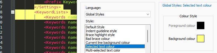

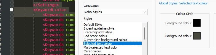

<li>Selected text colour:
<ul>
<li>default: <img src="/assets/uploads/files/1790263082002-6cf5b4c1-7b2e-47bc-8b20-47ad2ea1884a-image.jpeg" alt="6cf5b4c1-7b2e-47bc-8b20-47ad2ea1884a-image.jpeg" class=" img-fluid img-markdown" /></li>
<li>modified: <img src="/assets/uploads/files/1790263104839-6318a4e3-6d6a-4583-b949-855a439f304c-image.jpeg" alt="6318a4e3-6d6a-4583-b949-855a439f304c-image.jpeg" class=" img-fluid img-markdown" /></li>
<li>again, it does what I expect</li>

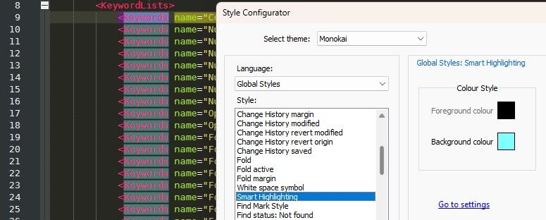

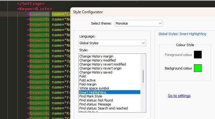

<li>Smart Highlighting:
<ul>
<li>default: <img src="/assets/uploads/files/1790263153651-1107e88c-b40c-4622-b0e9-d2676004c323-image.jpeg" alt="1107e88c-b40c-4622-b0e9-d2676004c323-image.jpeg" class=" img-fluid img-markdown" /></li>
<li>changed to cyan: <img src="/assets/uploads/files/1790263182686-3ba38b0a-1f92-4d9d-ba94-b36ef4d0c6f3-image.jpeg" alt="3ba38b0a-1f92-4d9d-ba94-b36ef4d0c6f3-image.jpeg" class=" img-fluid img-markdown" /></li>
<li>this one, it’s actually combing the selected color with the normal background color, so it’s not exactly the same color you chose; but again, that’s not unique to Monokai</li>
</ul>

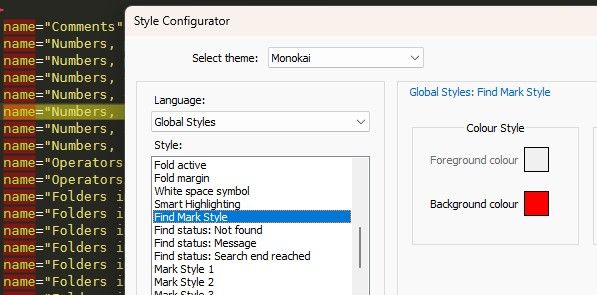

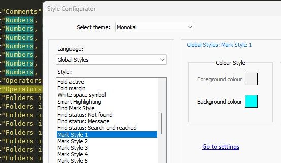

<li>Find Mark Style: used when you use <strong>Find &gt; Mark</strong> dialog
<ul>
<li><img src="/assets/uploads/files/1790263284015-0e9c9f44-f393-44ae-b29a-386e362939bd-image.jpeg" alt="0e9c9f44-f393-44ae-b29a-386e362939bd-image.jpeg" class=" img-fluid img-markdown" /></li>
</ul>
</li>
<li>Mark Style #: used when you use <strong>Search &gt; Style … Token</strong> options:
<ul>
<li><img src="/assets/uploads/files/1790263340517-131aa3df-93bd-4977-9bd9-3143c4a7fbcb-image.jpeg" alt="131aa3df-93bd-4977-9bd9-3143c4a7fbcb-image.jpeg" class=" img-fluid img-markdown" /></li>
</ul>
</li>
