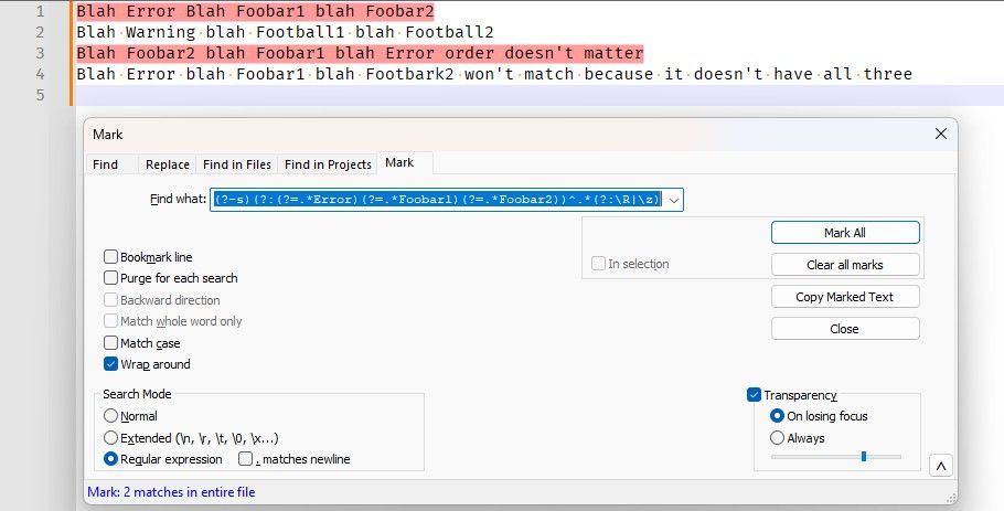

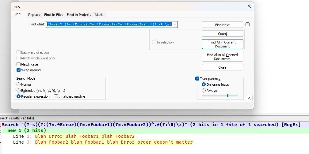

<p dir="auto">The first table in the FAQ is just showing the logic for matching all of those terms.  Later down in the FAQ, there is another table which explains how to find the exact line that matches all of those terms.  In your case, the AND would be <code>(?-s)(?:(?=.*Error)(?=.*Foobar1)(?=.*Foobar2))^.*(?:\R|\z)</code></p>
<p dir="auto"><img src="/assets/uploads/files/1787010625218-59c19de8-1eb3-41e3-9fd1-14abdcb43053-image.jpeg" alt="59c19de8-1eb3-41e3-9fd1-14abdcb43053-image.jpeg" class=" img-fluid img-markdown" /></p>
<p dir="auto">or, using the Find Results via Find All in Current Document:<br />
<img src="/assets/uploads/files/1787010757984-6f1d47c5-0787-4257-91c0-22189e1d79fc-image.jpeg" alt="6f1d47c5-0787-4257-91c0-22189e1d79fc-image.jpeg" class=" img-fluid img-markdown" /></p>
<p dir="auto">dummy example file to show it working:</p>
<pre><code>Blah Error Blah Foobar1 blah Foobar2
Blah Warning blah Football1 blah Football2
Blah Foobar2 blah Foobar1 blah Error order doesn't matter
Blah Error blah Foobar1 blah Footbark2 won't match because it doesn't have all three
</code></pre>

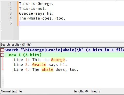

<p dir="auto">The Search Results panel is designed to only show one line per match (even if you do a search expression that matches text that crosses over lines, it will only show the first line of the match).  There isn’t a way to increase context.</p>
<blockquote>
<p dir="auto">Support for multiple keywords would be an additional plus.</p>
</blockquote>
<p dir="auto">The existing regular expression (regex) feature already handles that.</p>
<ul>
<li>Find What = <code>\b(George|Gracie|whale)\b</code>
<ul>
<li>the <code>\b</code> matches “word boundary” so it would match <code>George</code> but not <code>Georgene</code>, etc.</li>
<li>the <code>(...)</code> makes a group - without this logical group, the <code>\b</code> would have to be repeated at the beginning and end of each word, like <code>\bGeorge\b|\bGracie\b|\bwhale\b</code></li>
<li>the <code>|</code> means “OR”</li>
<li>translated to english, this Find What means “match a boundary, then <code>George</code> or <code>Gracie</code> or <code>whale</code>, then another boundary”</li>
</ul>
</li>
<li>Match Case = off</li>
<li>Search Mode = Regular Expression</li>
<li><code>. matches newline</code> = off</li>
</ul>
<p dir="auto"><img src="/assets/uploads/files/1786722146144-7274a6f0-798a-4c00-9466-d487a784e5af-image.jpeg" alt="7274a6f0-798a-4c00-9466-d487a784e5af-image.jpeg" class=" img-fluid img-markdown" /></p>
<p dir="auto">–<br />
From our FAQ section, the Generic Regular Expression formula FAQ links to a post <a href="/topic/22677">Generic Regex: Logic Gates for Regular Expressions</a> which explains how to match lines with AND, OR, Exclusive-OR, and similar logical constructs.</p>
]]></description><link>https://community.notepad-plus-plus.org/post/106099</link><guid isPermaLink="true">https://community.notepad-plus-plus.org/post/106099</guid><dc:creator><![CDATA[PeterJones]]></dc:creator><pubDate>Fri, 14 Aug 2026 15:48:24 GMT</pubDate></item></channel></rss>
