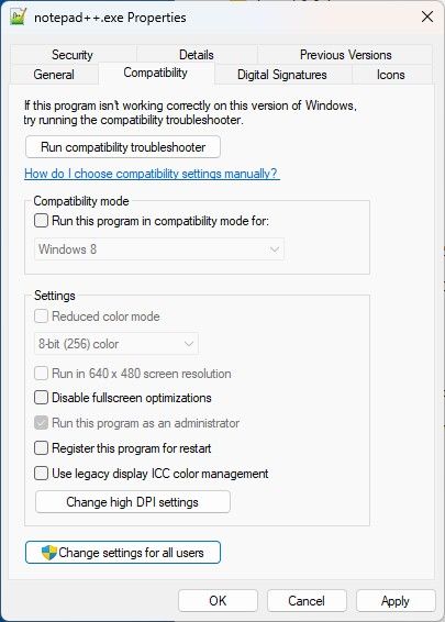

<p dir="auto">If you are seeing that option greyed out while enabled, like this:<br />
<img src="/assets/uploads/files/1786662339129-a46348ad-0f0c-4ddf-a184-c62fa03226f2-image.jpeg" alt="a46348ad-0f0c-4ddf-a184-c62fa03226f2-image.jpeg" class=" img-fluid img-markdown" /></p>

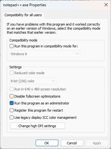

<p dir="auto">then you have to click <strong>Change settings for all users</strong>, where it shouldn’t be greyed out:<br />
<img src="/assets/uploads/files/1786662367454-15355079-189d-405d-bc8a-41d313254870-image.jpeg" alt="15355079-189d-405d-bc8a-41d313254870-image.jpeg" class=" img-fluid img-markdown" /></p>

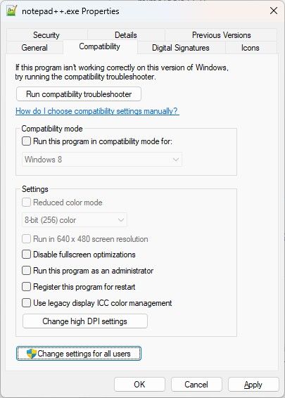

<p dir="auto">When you uncheckmark it there, then <strong>OK</strong>, the all-users dialog will close and the original Properties will update to not greyed out and it will be uncheckmarked, too:<br />
<img src="/assets/uploads/files/1786662403452-a387aa38-2df4-44b8-b56b-43ec0773ff82-image.jpeg" alt="a387aa38-2df4-44b8-b56b-43ec0773ff82-image.jpeg" class=" img-fluid img-markdown" /></p>
<p dir="auto">Now Notepad++ should stop running as Admin.</p>
