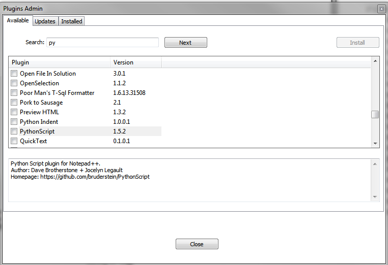

            If you are using a newer npp version you need to update the python
            script plugin version as well as the newer npp version did introduce
            a newer and changed scintilla version which affected the notification structure.
            Depending on your currently used version of npp the installation procedure is different but if you are using the most recent version,
            you should be able to reinstall PS via the plugin admin.
            • Bérci RóbertB
              Bérci Róbert
              @Ekopalypse
              Thanks. That did the trick.
