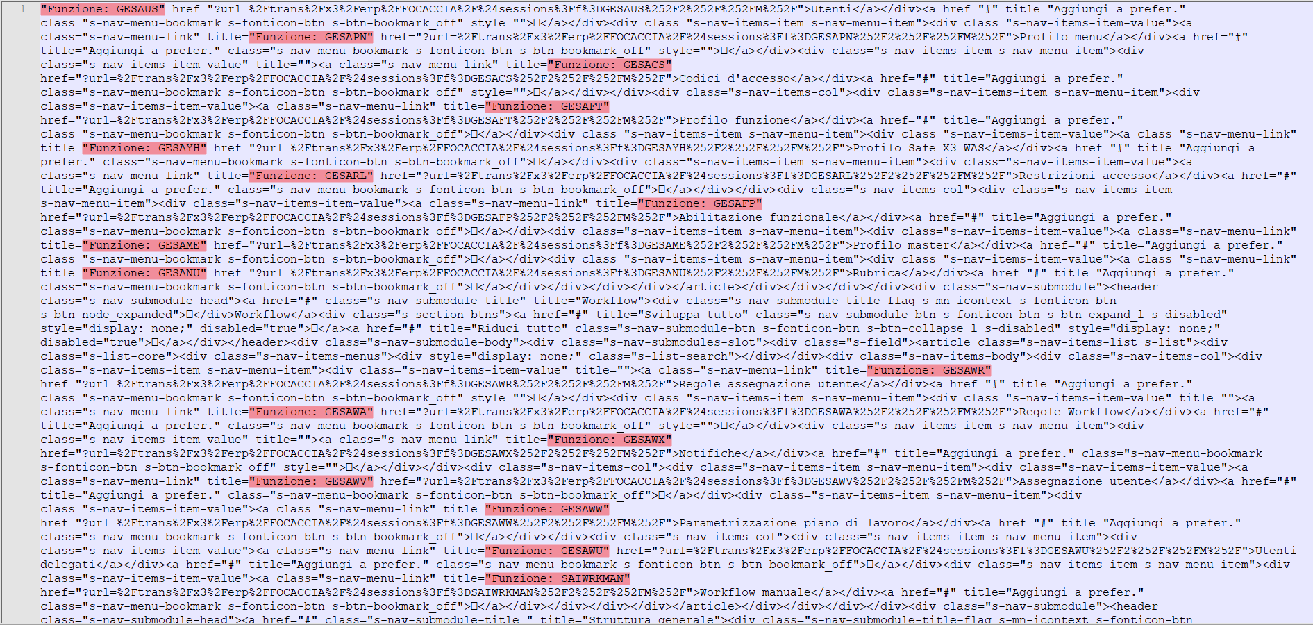

                  • Raffaele PretolaniR
                    Raffaele Pretolani
                    This is my file from which I have to delete everything except the highlighted parts.
                    As you can see, all the text is in a single line (line 1).
                    To select the elements I used the “funzione:.*?” formula.
                    I can’t find a way to delete everything except the highlighted one.
                    With the formulas mentioned above by users, in any case, the “Search” finds me as a result, everything and not everything - “funzione:.*?”.
                      Thanks for giving us more to go on…
                      I can come “pretty close” to what you describe.
                      Assuming you have data like
                      blah "Funzione: ABCD" blah blah "Funzione: 1234" blah blah "Funzione: r2d2" blah blah "Funzione: !123!" blah
                      Then the regex
                      • FIND = .*?("Funzione:.*?")
                      • REPLACE = $1\r\n
                      • mode = regex
                      will result in
                      "Funzione: ABCD"
                      "Funzione: 1234"
                      "Funzione: r2d2"
                      "Funzione: !123!"
                       blah
                      If there was anything after the last "Funzione:...", it will show up on the last line of the replacement, but there will be only one of those, so you can just manually delete that last line a single time. (It would be possible, but more complicated, to do it all in one regex. I often prefer doing regex operations in 2-3 steps, rather than spending 2x-3x as long trying to debug a single regex that will do it all.)
                      If you want spaces rather than newlines separating the matches, just use a space (or \x20) instead of the \r\n in the REPLACE. If you want nothing between (so the quotes will jam up next to each other), then just REPLACE = $1.
                      Raffaele PretolaniR 1 Reply Last reply Reply Quote 3
                        Raffaele Pretolani @PeterJones
                        PERFECT!
                        That’s exactly what I was looking for.
                        Thank you very much, and sorry if I wasn’t clear.
