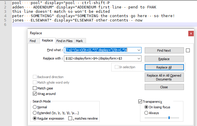

            PeterJones @Scott Smith 0
            @Scott-Smith-0 ,
            You’re still not doing a good job of explaining it, but I think I might understand. Your data is in the form SHORTNAME spaces SOMETHING quotemark space-display-equal quotemark SOMETHING space CONTENTS, and you want to transform it to SHORTNAME spaces <displayform>CONTENTS</displayform>SOMETHING. Assuming that’s the rule:
            • FIND = (?-s)^(\w+)(\h+)(.*?)" display="\3\h+(.*)$
            • REPLACE = $1$2<displayform>$4</displayform>$3
            • MODE = regular expression
            Original data:
            pool    pool" display="pool - ctrl-shift-P
            adden    ADDENDUM" display="ADDENDUM first line - pend to FHAK
            this line doesn't match so won't be edited
            peter   SOMETHING" display="SOMETHING the contents go here - so there!
            jones   ELSEWHAT" display="ELSEWHAT other contents - now
            Final data:
            pool    <displayform>- ctrl-shift-P</displayform>pool
            adden    <displayform>first line - pend to FHAK</displayform>ADDENDUM
            peter   <displayform>the contents go here - so there!</displayform>SOMETHING
            jones   <displayform>other contents - now</displayform>ELSEWHAT
            Hmm, this doesn’t match on the pool line… I still obviously don’t understand your rules, because in the pool line, you put the pool wrapper both after the <displayform> and after the </displayform>, whereas in the adden example in your recent post, you only put the ADDENDUM after the </displayform>, and I don’t see how to decide between the two; going back to your original example, the ADDENDUM did come both after the <displayform> and after the </displayform>. If that’s really what you want, then change to
            • REPLACE = $1$2<displayform>$3 $4</displayform>$3,
            which will have final data of
            pool    <displayform>pool - ctrl-shift-P</displayform>pool
            adden    <displayform>ADDENDUM first line - pend to FHAK</displayform>ADDENDUM
            peter   <displayform>SOMETHING the contents go here - so there!</displayform>SOMETHING
            jones   <displayform>ELSEWHAT other contents - now</displayform>ELSEWHAT
            If the number of spaces between SOMETHING and CONTENTS is also important, then you can capture those spaces into a separate group, which will renumber some of the above groups
            • find= (?-s)^(\w+)(\h+)(.*?)" display="\3(\h+)(.*)$
            • replace = $1$2<displayform>$3$4$5</displayform>$3
            spaces    WHITESPACE" display="WHITESPACE                   lots of prefix spaces
            becomes
            spaces    <displayform>WHITESPACE                   lots of prefix spaces</displayform>WHITESPACE
