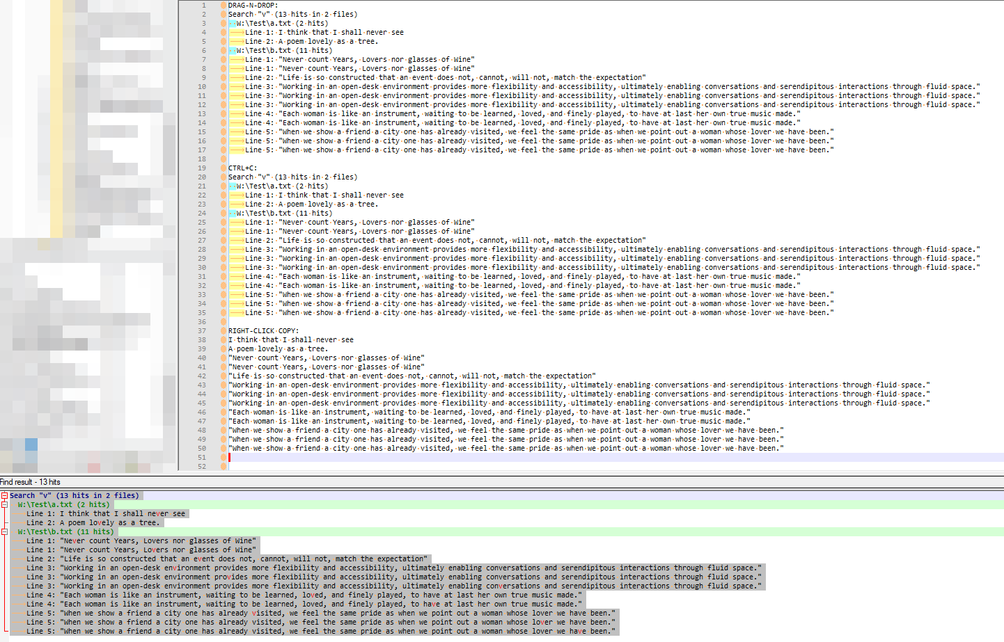

        My script code has a .getText function on the FindResultPanel object.
        With it I can, obviously, get the text of the Find-result window.
        However, I’d like to be able to get the matching text, but I don’t know how to accomplish this.
        Visually, I can see the hit results in the window as red text on a yellow background.
        Anyone know how I can pull this information?
